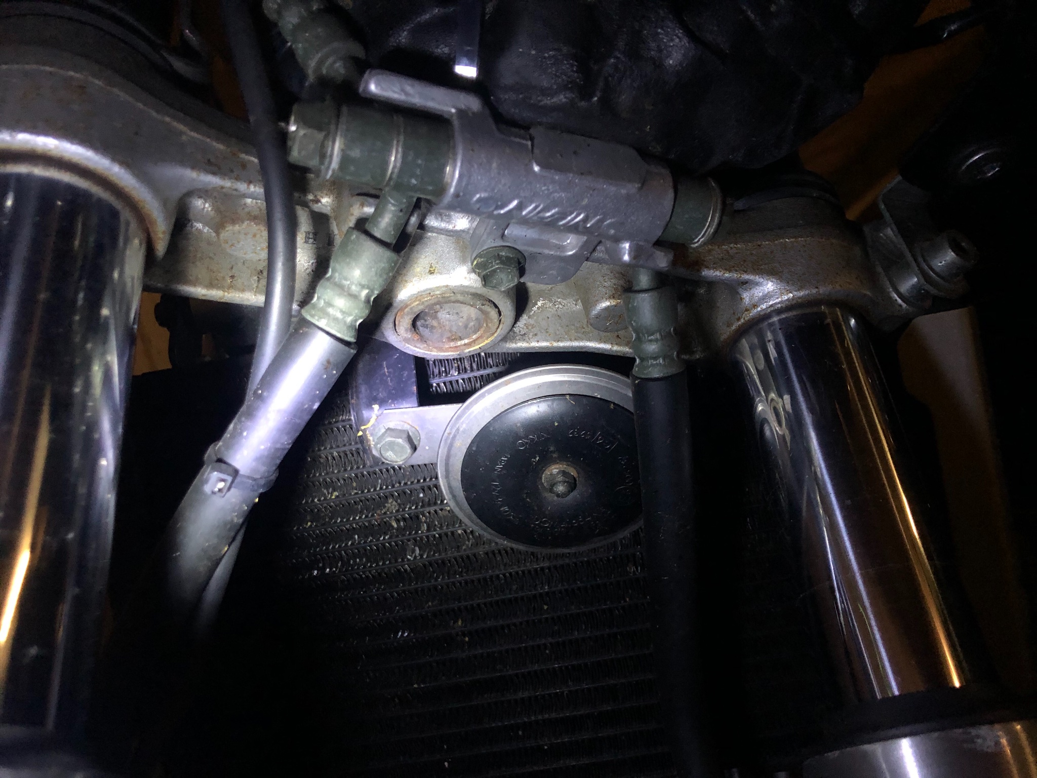

#2933
Beitrag von Kathillerie » 02.02.2021 17:58
Dieses Loch?
The story so far:
In the beginning the Universe was created.
This has made a lot of people very angry and been widely regarded as a bad move.
Beiträge: 12774
#2934
Beitrag von Pat SP-1 » 02.02.2021 17:59
Genau
