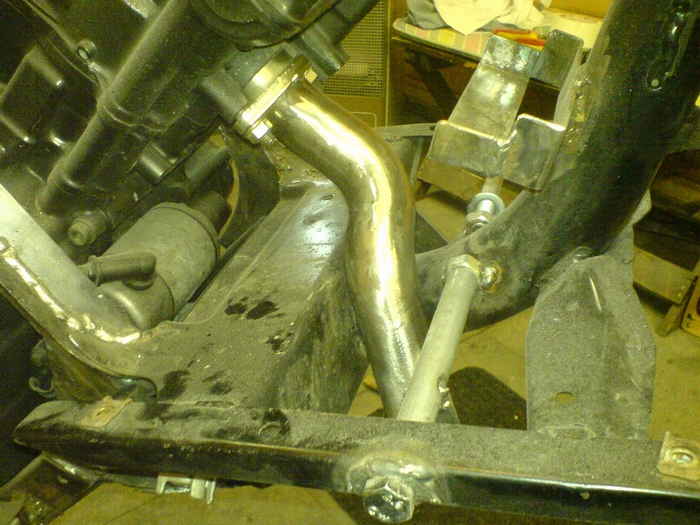

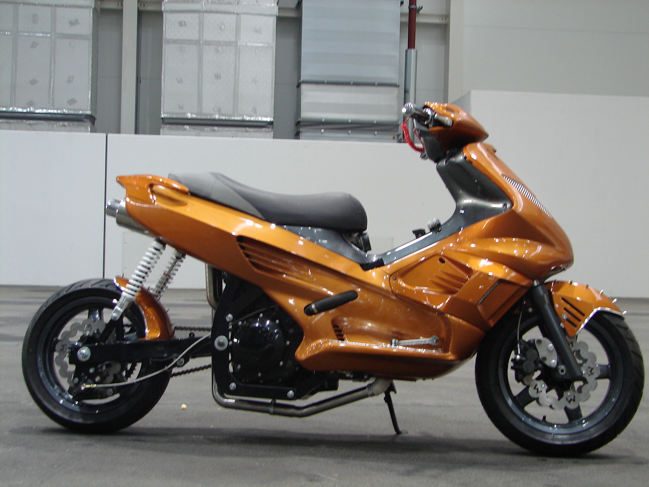

Bilder der auspuffanlage? gerne:
http://s5.directupload.net/images/user/ ... gskdlf.jpg
http://s4.directupload.net/images/user/ ... r6shw4.jpg
http://s2.directupload.net/images/user/ ... aht48u.jpg
http://s6.directupload.net/images/user/ ... 6onaap.jpg
http://s5b.directupload.net/images/user ... giaiid.jpg
Re: Gegendruck vom Auspuff notwendig?
